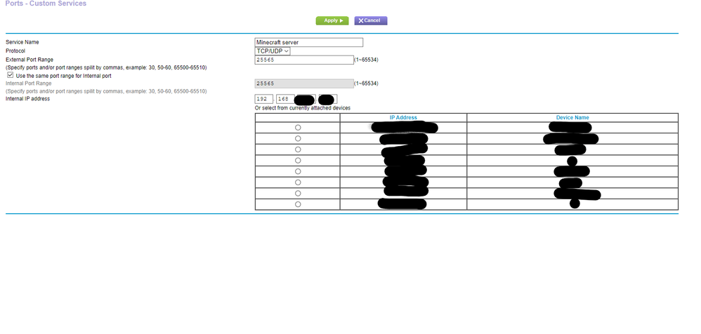

Port forwarding on r8000 not working
I am trying to open port 25565, but it when i use https://www.canyouseeme.org it says timed out
I am trying to make a minecraft server
I know little about port forwarding

  • > >I have tried port forwarding inside of the main router using the
    > "88.90.##.## address, but it don't seem to work
       What was the actual port-forwarding rule there?
    >     >Even if the server is up and running while I test it, it says:
    > "Connection timed out"
       It won't work is the server is not on the LAN subnet of the main
    router.
    > IPv4 Address. . . . . . . . . . . : 10.0.0.37
       An R8000 would do that if it's configured as a router, and its
    WAN/Internet port is connected to another router which is using
    "192.168.1.*" for its LAN.
    > How do I configure it like you said?
    >    Visit http://netgear.com/support , put in your model number, and look
    > for Documentation.  Get the User Manual.  Read.  Look for "Use the
    > Router as a Wireless Access Point". [...]
    > DHCP is enabled:
       The change to WAP mode will stop that.
    > Here is the main menu, tell me what you want me to click on and I will
    > copy the information and reply with it
       Too much work.  I'd guess that Address Reservation would be under
    "DHCP" or "LAN hosts".  I'd look for port forwarding under "Port
    forwarding".
    > I don't wanna mess up my parents WIFI or stuff tho
       Adding an address reservation or a port-forwarding rule should be
    pretty safe.  But, safe or not, the main router needs to do the port
    forwarding.
    > Your friends use your (one, only) public IP address ("88.90.##.##")
    > to talk to your main router -- the router which is connected to your
    > ISP. [...]
    So, the main router must do the port forwarding.
       And the server must be on the main-router LAN subnet.  So, directly
    connected to the main router, or else connected to the R8000 when the
    R8000 is configured as a WAP.

    • 4IDp8's avatar
      4IDp8
      > I am trying to open port 25565, [...]
         In my experience, people who talk about ports being "open" or
      "closed" often don't understand the problem.
      >>What do you mean by that? I am trying to make it so people outside of my network can connect to the server on 25565.

      >>An image of my screen while adding a new port
           Not a big improvement over the hidden picture.  While we're waiting,
        go through that previously cited thread.
