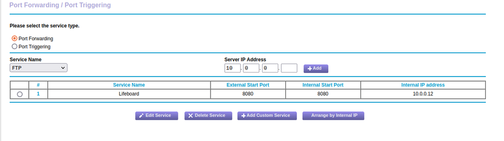

I am having an issue with port forwarding. I have two laptops running off the same Netgear router (@10.0.0.1) - one at 10.0.0.5 and the other at 10.0.0.12. The apache server on 10.0.0.12 is listening on port 8080. Here is how I have this set up in my router

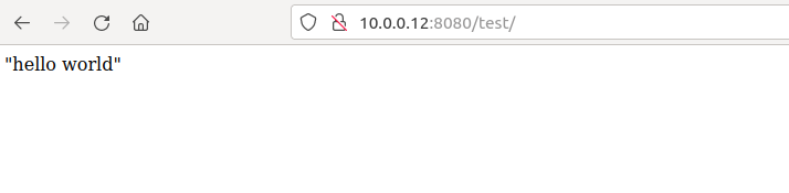

I can connect directly to the server using http://10.0.0.12:8080/test in a browser and it works fine

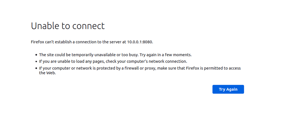

But when I try and connect through my router at 10.0.0.1 (http://10.0.0.1:8080/test), I get
       Looks plausible to me.
    > in a browser [...]
       "connect directly to the server" from _where_?  Itself?  The
    (unspecified) system at "10.0.0.5"?  Other?
    > (http://10.0.0.1:8080/test), I get [...]
       Seems as if it ought to work, doesn't it?
    > what am i doing wrong?
       Other than the sloppy problem description?
       Relying on my notoriously weak psychic powers, my first guess would
    be that you're using a D7000v2, whose firmware is defective, in that its
    doesn't do NAT loopback (on which you're relying in such a case).
       To what is the WAN/Internet side of this mystery router connected?
    Did you choose the "10.0.0.*" subnet intentionally for some reason or
    other, or did the router choose it because it saw that its WAN side was
    connected to a "192.168.0.*" subnet, or what?
       If the D7000v2 hypothesis is correct, then you might try accessing
    your server from a system on the WAN side of the mystery router (using
    the WAN/Internet address of the mystery router in the URL).
