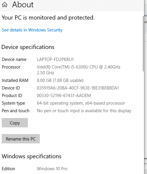

i had to start using an old lenovo as a stop gap until i get a new laptop. the laptop triggers my router (which i also got secondhand) to disconnect but it did not cause my even older previous router to do so. it makes everything (wifi and ethernet) lose connectivity until i restart the router. and it only happens when the laptop is started and i attempt to access the internet (e.g. play something on spotify and it briefly plays for a few seconds before everything on the laptop and my other wifi connected devices lose access). otherwise the router works fine (and not every time so i'm not sure what triggered it in the startup process).
Lenovo thinkpad x270 on windows 10 (configs below)

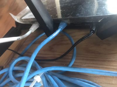

      thank you for your help and the instructions! let me know if this helps clear up my problem: the firware according to the app is up to date and the latest i.e. V1.0.9.88 (see attached)

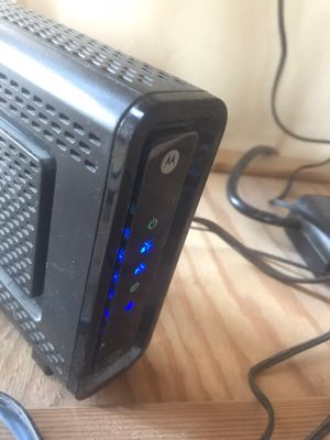

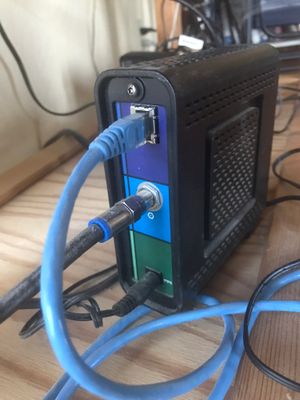

      the modem is my older one which has always worked with any router or laptop i pair it with --  motorola surfboard sb6121 (see photos attached)
      by disconnect i mean every device and laptop suddenly stops being able to connect to the internet even if it was on wifi (the laptop that triggers this is connected via ethernet and i tried all 4 ports)
      and the lights all still look normal, lit up and white so no signs of failed connection
      how do i check if windows suddenly causes this with one of it's processes? it didn't do it to any of my other routers and i also run windows on wifi on another laptop and it works fine
