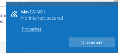

If the R6400v2, set up as a bridge following the manual instructions for "Set Up the Router in Bridge Mode" is connected to the R6080 over the 2.4 Ghz band, no other devices can connect to the 2.4 Ghz band and access the internet (they can connect, but they cannot access the internet):
The same is true if I connect the bridge to the 5Ghz band, at which point no other wireless devices can connect to the 5Ghz band and have internet access. But, if I connect my other wireless devices to the opposite band to that which the bridge is connected, then they can connect and have internet access without issue. This seems like either a setup issue or a flaw in the way the R6080 works. Or, maybe there's a legit reason the wireless bridge cannot share the same frequency with the primary as all other wireless devices on the network. I just haven't seen any explanation for it.

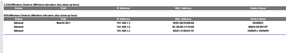

Sitting idle, I can see the R6400v2 is connected to the R6080 and has Good Internet status. It sees three devices: the R6080 at 192.168.1.1, and my two other PC's at 192.168.1.2 and 192.168.1.6.
When I plug my laptop into the R6400v2 using an ethernet cable, the other two PC's lose internet connectivity, though they still show as connected (wireless adapter shows "connected, no internet"). The status for the Bridge now says "No Internet".
If I connect these other two PC's to the opposite band, they will both connect and have internet access.
Here is what the R6080 sees before pluggin in a laptop to the R6400v2:
After this test, I forced the R6400v2 IP to be 192.168.1.100 from the R6080 LAN settings to see if it would make a difference. It did not. So, it don't be confused by that IP in the next shot, which is the R6080 view after plugging my laptop into the R6400 in a subsequent test:
There you see the laptop (MAV2012-PC) and that interesting unidentified mystery MAC address.
Here is the view from the R6400 at this time.
Note that the mystery MAC address is actually the R6080 MAC address. I don't know if that's normal to see, or something isn't set right.
