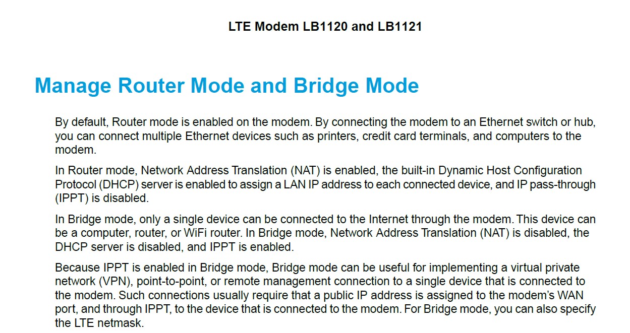

        Johnmuledeere wrote:
        Nice try - no cigar.  The LB1120 is a cellular only modem.  It is set to "Router" mode that according to Netgear disables all ISP intercepts and is a clear pass-through to the R6700V3 WIFI Router.  The entire system, end to end has undergone both factory resets and cold starts.  The Netgear software and firmware as I indicated are at current levels.  I do appreciate your efforts to help resolve this thing. Please keep trying.  The original rejection by outlook looks like a simple setting.  I just can't find it.
        Thanks
        Johnmuledeere
        Recommend you double check your definition of router mode function.  Attached is a snip from the LB1120 manual with a very different definition.  If you want to use your R6700V3 Wi-Fi router connected to your cell modem, you need to configure your modem to bridge mode.  The most you have to lose in bridge mode is that it does not work.  Just where you are now.
