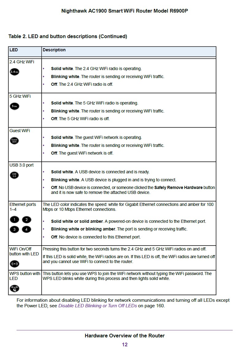

  • First question.  Do you have the 2.4 GHz band and the 5 GHz band set with different SSID's?  If not, suggest you name the 5 GHz band with xxxx_5g where xxxx is the SSID for your 2.4 GHz band.
    On the group of LED indicators on the front, do both the 2.4 GHz and 5GHz show as constant or blinking white?
    The attached page snip is from page 12 of the user manual.  The manual is available in the Downloads section above.  Review the description for the 2.4 GHz band.

    The 2.4 GHz LED is on?
