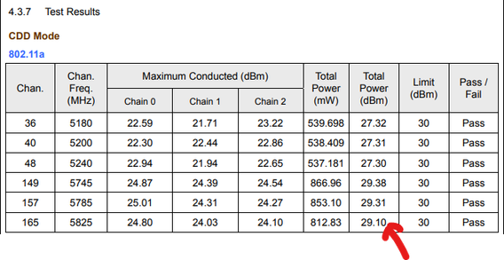

Found it !
I used the FCC ID Number on my R7000-100PAS unit.
Page 49 indicates 29.10dBm
https://fccid.io/PY318300420/Test-Report/RF-Test-Report-4107484.pdf

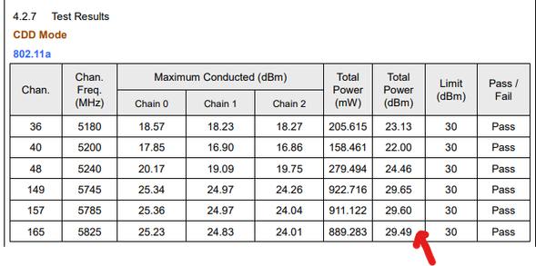

That may have changed too.- JohnNadeauApprentice
As it turns out, I found an FCC Test from 2018 that indicates 29.49 dBm.
https://fccid.io/PY313200233/Test-Report/RF-Test-Report-3854129.pdf
I would assume this would be the North American R7000-100NAS model given the test by the FCC.
Found it !
