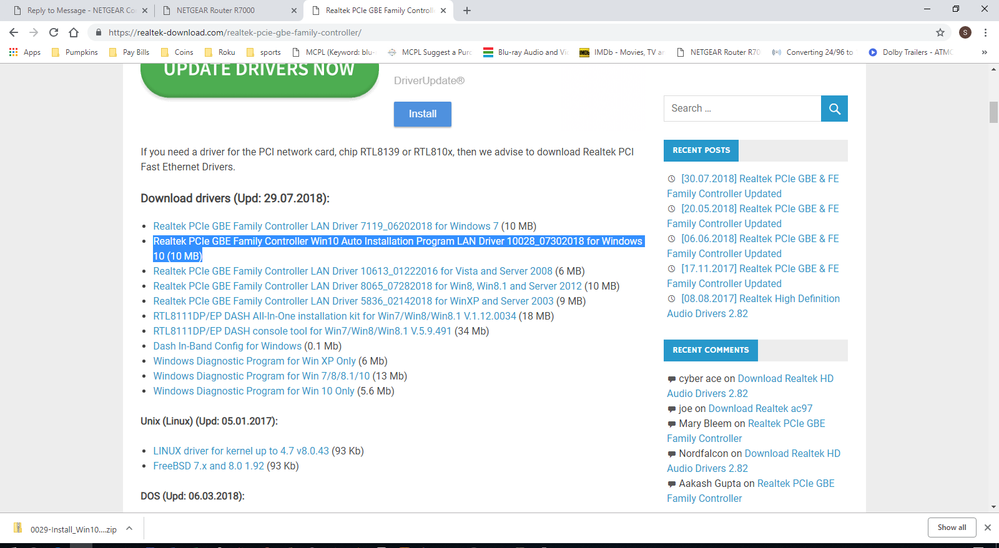

    I found drivers for the at the REALTEK SITE, I'd use those.

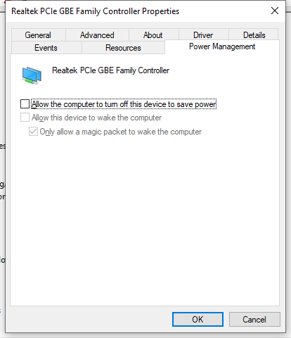

    What exactly is your network adapter and what chipset does it use? Is it the "Realtek PCIe GBE Family Controller"? If it is, check my screenshot. I'm on Win10 Home, V1809, and my NIC is actually older and works (it is NOT in use now) fine as of about 5 weeks ago, and had worked fine wih the R7000 I had connected about 10 months ago.

    When I look at the date of the driver's timestamp on the last line, it is 7/29/2018. It could very well be the same one on the RealTek site as it would be included in that package because the RealTek site has the SAME date? Of course the real Driver is that last line. Possible MS installed it along with V1809 even? Just need the .SYS file possibly?
    Check what you have before trying to update, but if you do, get it off the RealTek site, much safer. Quite possible if you do try to install it it could even tell you you are up-to-date even?
    Did you check all the properties for Power Management as well as the Power Plan?

    That last link explains how to change things. However there is a per device setting as well. Using Device Manager look at your Network devices and double click on each one. You should see a POWER MANAGEMENT tab and on that tab a box to control if the device should be turned off or not to save power. It might be on, so uncheck it. This will keep it on and connected.

      I have turned off all boxes on the Power Management tab.  These were previously on.
