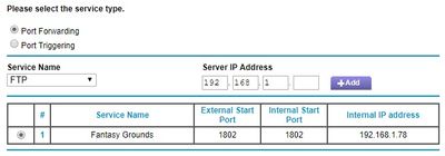

I'm trying to get a program called Fantasy Grounds working, and it requires port forwarding of port 1802. I've done this on the same ISP at other locations, and recently moved to a new place in the same city, same ISP. But now I have a R7000 Nighthawk router.
I set my PC to a static IP address, and also set a reservation for it in the router interface to make sure nothing else gained that address and causes a conflict. (192.168.1.78 is the address)
Then in the router interface (web), under Advanced > Advanced Setup > Port Forwarding / Port Triggering I setup a rule for a new custom service for Fantasy Grounds, setting the internal/external ports to 1802 pointing to the internal IP address 192.168.1.78.

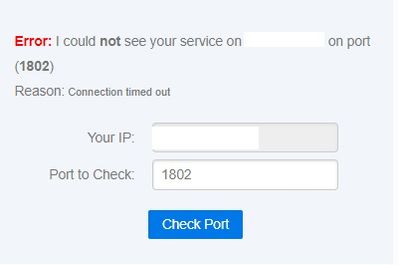

Then I went to canyouseeme.org to test the port forwarding, and it times out.

is the program running when you use that website to check the port status? if the program is not running, that website will report the port as closed
No dice. Still not working.
did you punch a hole in the Windows/MacOS firewall?
