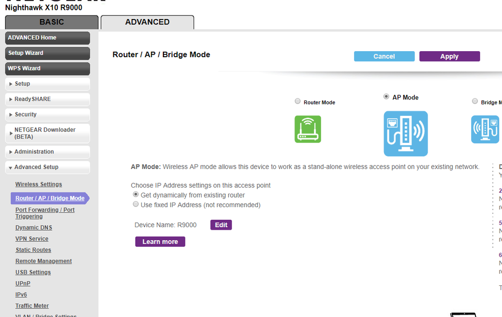

    Hm, don't think you have to reset ... When you go to  Advanced -> Advanced Setup -> Wireless AP where you can tick the (x) Enable AP mode, and scroll down ... there should be everything (e.g. the choice for selecting DHCP client or a static IP) you are behind. It's not a part of the Advanced -> Advanced Setup -> LAN setup, indeed.
    Here the UI as it looks in the "new" design where we set the mode to AP - must be different from your R7000P - but the functionality is the same:
    Seriously, the time we spend to write here is much more than factory reset a R7000P and re-configure the hand full of data it from scratch as an AP - and doing it right away the way you want it ..... when I have it right the R7000P does handle it that way -> I’m setting up my NETGEAR router for the first time, how do I set it to Access Point (AP) mode? ... the biggest problem is that the WAN/Internet port must be used ... obvious to avoid the duplicated default LAN IP.

       Yes, and that normally happens (with no extra effort) when you select
    "AP Mode" to configure the router as a wireless access point.  See "Use
    the Router as a WiFi Access Point" in the R7000P User Manual.  ADVANCED
    > Advanced Setup > Router/ AP / Bridge Mode : AP Mode ...
    > [...] I chose the last address in my router range. [...]
       So, you also chose "Use fixed IP settings on this device (not
    recommended)", rather than "Get dynamically from existing router"?

       Of course, if you use the default option, "Get dynamically from
    existing router", then you won't immediately know what that address is.
    It should be available from an "Attached Devices" report from the main
    router, and, if you want the R7000P-as-WAP to have some particular LAN
    IP address, then you should be able to reserve a dynamic address for it
    on the main router (as you could do for any other device which is
    connected to that main router). ADVANCED > Setup > LAN Setup > Address
    Reservation ...
