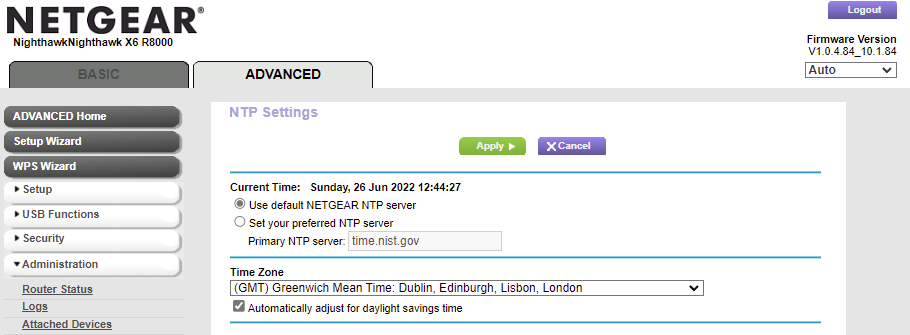

      • FURRYe38's avatar
        Are you selecting the GMT for UK as seen here?
