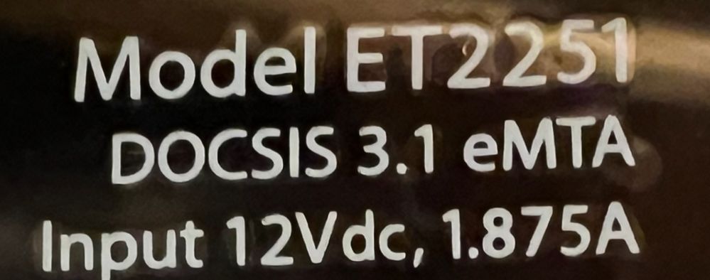

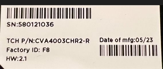

      If that is the modem, then it seems to be a standard modem only device. Hard to tell with that information.
