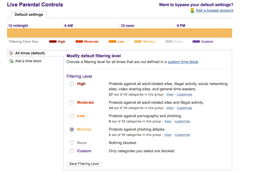

Terry - DjRiDeJan 11, 2018Apprentice
Hi Terry,
I had to create an account access the parental side of the router settings. I just did and when i went to it I didnt see anything about disney controls - Here's a screen shot of it.
- TerryPhJan 11, 2018VirtuosoHi DjRiDe,
I assume that you created parental control account by DDNS account, if you don't have Circle, and this confirms that you are running older firmware version.
