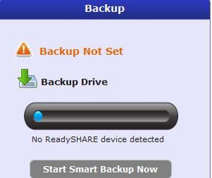

ReadyShare Vault: No readyshare device detected
Hi, I installed today my Nighthawk R7000 and I like the extra options but... I tried to configure ReadyShare vault on it and it says No device detected. I Tried the following things and i hop...
- Dec 04, 2016
I fixed it. I had a password setup for Read/Write only acces for username admin. So i disabled the password request and now it is detected.

I did testing just using the R7000 for the ReadyShare features, and found that the WAN port must be in use, connected to the internet.
My finding is this: The R7000 must be your main router & gateway, not just another device on your existing network.
You didn't say whether or not you were using the R7000 as you main router, but I tried to use mine just for ReadyShare and
it just refused to be a ReadyShare device unless it was the main router.
Is that the problem?
