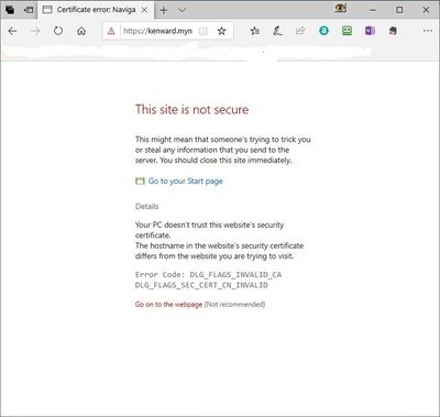

        That is probably your browser objecting to what it sees as a security lapse.
        What happens with a different browser? Most will have a link that you can click.
        For example, here's what I see in Edge:
        Chrome has a similar "Get out of jail" link.
