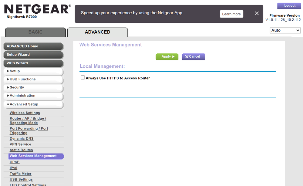

Remote Management missing in R7000 after upgrading to 1.0.11.128
After upgrading from '126 to '128, my R7000 "Remote Management" features disappeared.
Under the Advanced/Web Services Management tab, the checkbox, "Turn Remote Management On" and everything below it is missing.  However, "Local Management" and the checkbox, "Always Use HTTPS to Access Router" are still there.

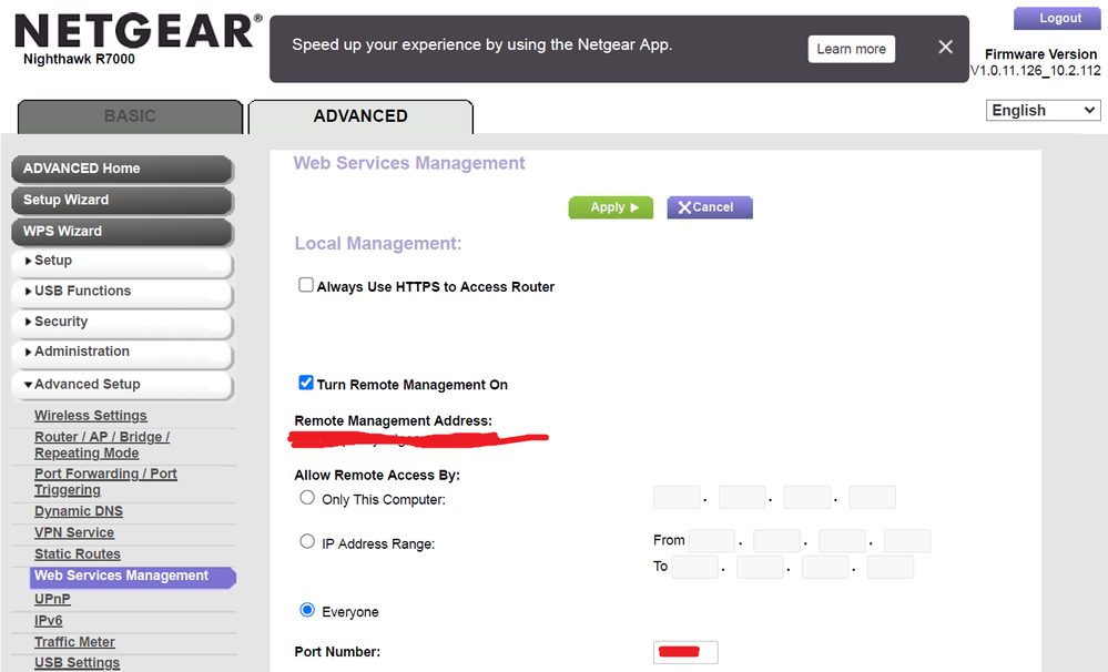

  • Below are screen shots both before the upgrade (with '126) and after the upgrade (with '128).
    I did the upgrade again and got the same result.  I'm baffled.  Any help would be appreciated.

  • The same thing happened with my R6400. I'm going to try to roll back to a previous version of the firmware if I can find one.
