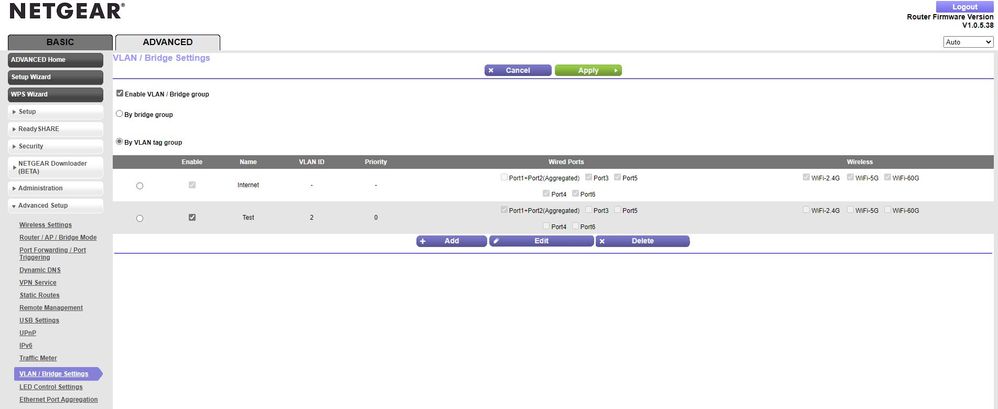

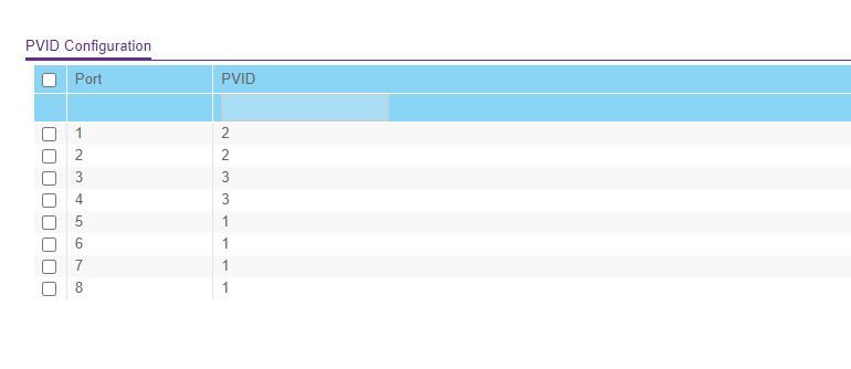

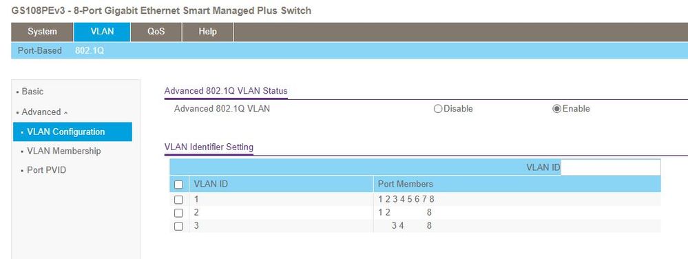

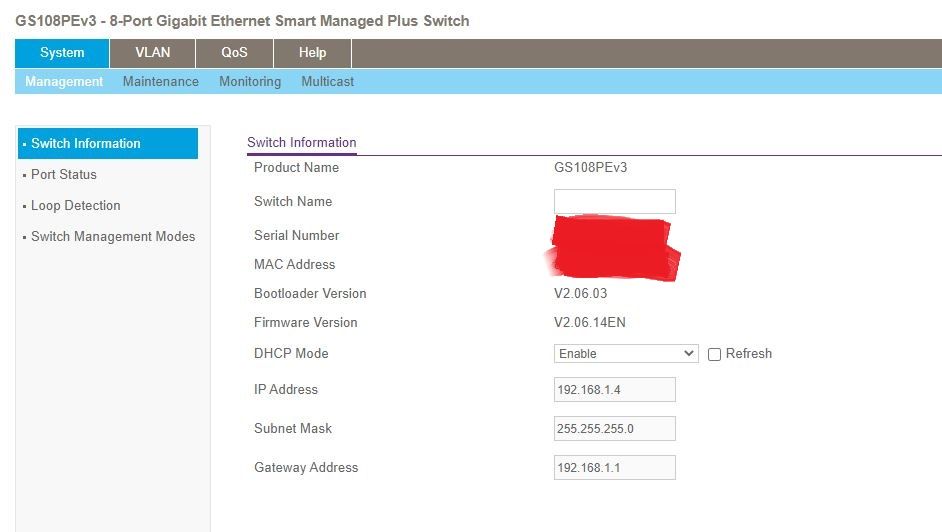

I have been reading KB articles and watching youtube videos in a bid to accomplish this goal and despite my readings suggesting that my current equipment is sufficient, I am not able to access the internet at all if I enable and configure VLAN / Bridge group on the R9000. Will someone please assist me with this because I am afraid I am spinning my wheels at this point. Is the R9000 router not actually suitable for this task? If so, please let me know so I can buy something that is suitable. I've included images of my switch config (n=3) and router config (n=1) based on instructions I've followed from...

    Simple: The R9000 does (like any other Netgear consumer routers) not support any VLAN multi-network configuration on the LAN side.
    The VLAN/Bridge group does allow handling some dedicated VLAN on the WAN/Internet side (like IPTV typically) over to the LAN, eg. bridging to defined port(s).

      Understood, thanks. It appears that I will need to buy a router/firewall, capable of 802.1q, for my network stack to accomplish my objective.
