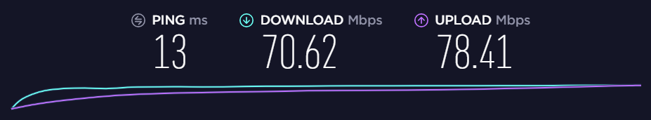

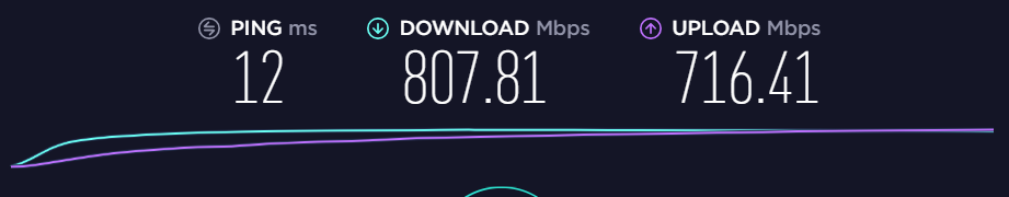

- R2dTOOJan 13, 2019Guide
Here are speed tests from my laptop. The first is wired. The second is wireless (connected to 5G). I also downgraded the firmware to V1.0.9.42_10.2.44.
WiredWireless
