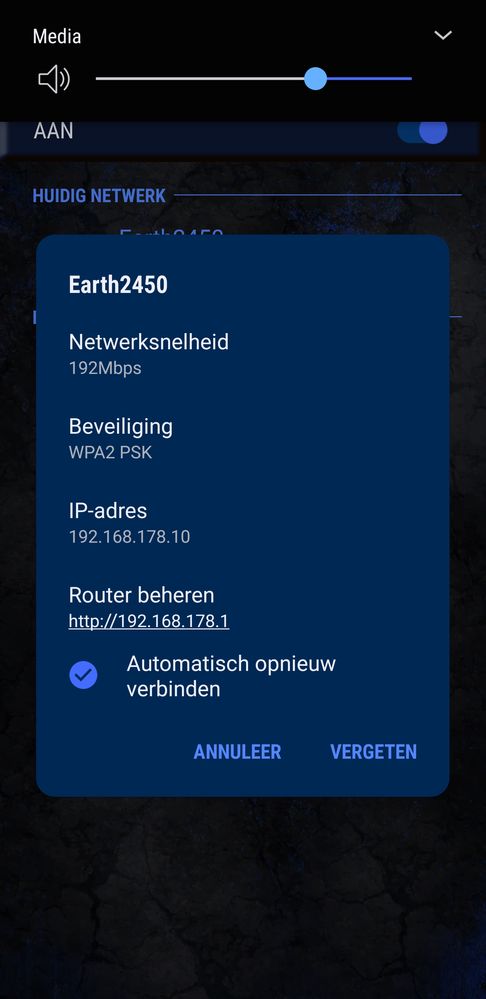

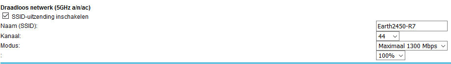

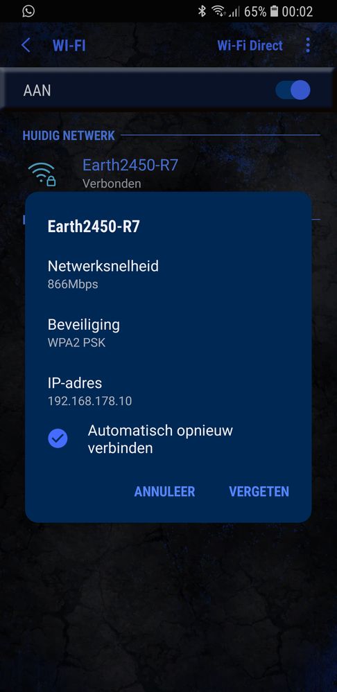

I have 1GB lan and was talking about 5Ghz not 2.4Ghz.
The r7000 can go up to 1300Mbps
On my Samsung phone I have this connection speed with Ziggo router
On my Samsung phone I have this connection speed with R7000 AP:
With my Samsung TV its about the same connection speed. So I am only talking about the connection speed between the AP/router and my Phone (or TV)
