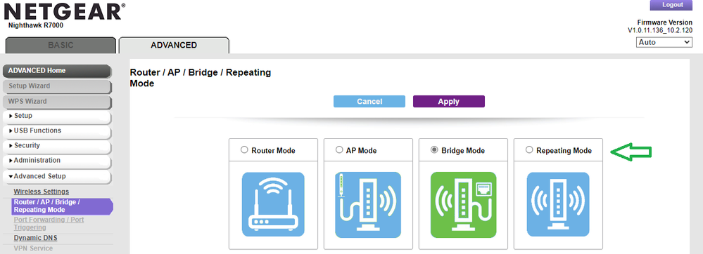

Though this model router doesn't support a actual "Extender" mode, it does support wireless Repeater mode:
