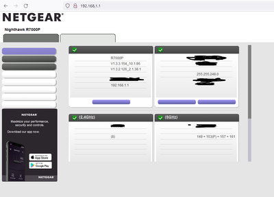

WEB interface labels blank?
Has anyone seen this? Tried Opera, FF and Edge, same results.
A 'normal' restart did not work. However leaving the power adapter unplugged w/ the power switch on for a minute did work and now the interface labels are back.

Be sure to clear out all browser caches before entering the web page.
Disable any web browser add-ons if you have some.Try a factory reset and setup from scratch?
- st000001Tutor
I tried w/ a browser I never use and for sure had never used for the router - and same results so I don't think it is cache.
I can try a reset but it is a lot of setup.
Will need to be tried.
Glad you got it working. Be sure to save off a back up configuration to file for safe keeping. Saves time if a reset is needed.
