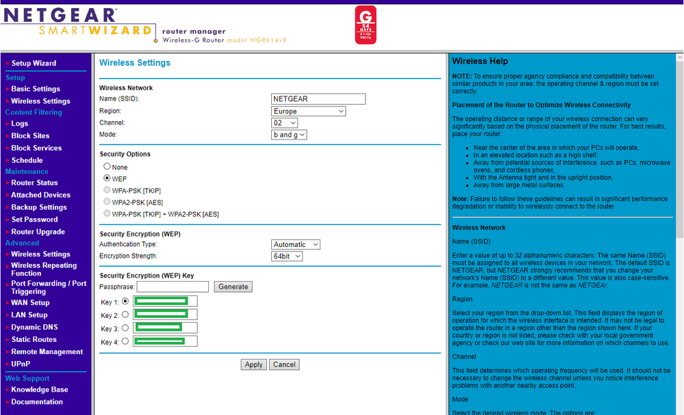

Hello everyone! I have a router WGR614v9, it is ~10 years old. I want to change the security level from WEP to WPA, but they are disabled. I updated the firmware to the latest version, it did not help. How do I activate WEP?

- microchip8Master
Your router does not support WPA. It's a relic
Thanks for your reply! Is this a fact or is this your assumption? The official manual says that there is a WPA and shows how to configure it. But in manual it is active =\
https://www.downloads.netgear.com/files/GDC/WGR614V9/WGR614v9_UM_14May08.pdf
- plemansGuru - Experienced User
Did you ever try simply factory resetting the router and reinstalling it using wpa/wpa2?
Hello! Thanks for your advice, factory reset helped, my "relic" works now with WPA :)
