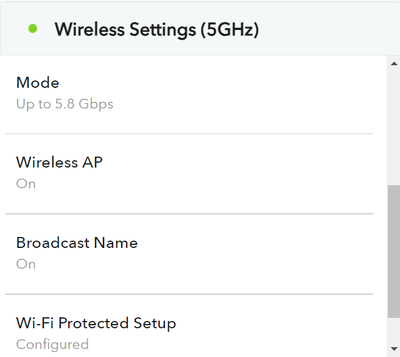

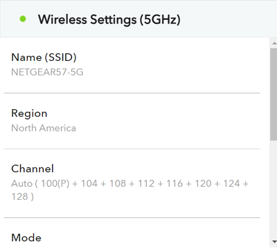

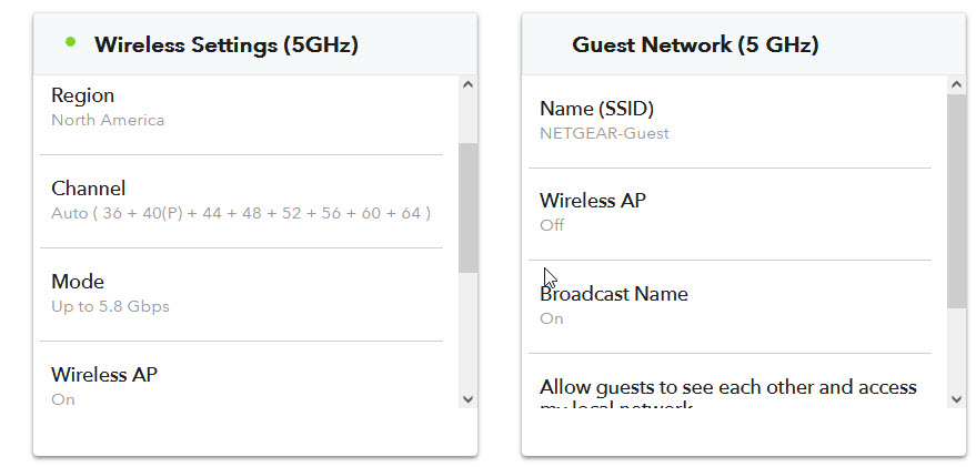

      Can you share the complete screenshot of the 5GHz tile on the Web GUI / ADVANCED tab dashboard like this?
