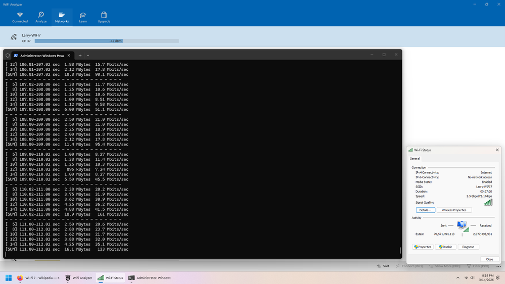

This is what it looks like when it's working and forced to a slightly weaker signal around 53db.

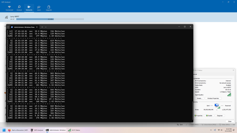

This is what it looks like when the signal is stronger and 4kQAM is utilized on the link.
As you can see the rate set for the uplink swaps to a 4kQAM mode while the downlink crashes and almost appears to be using the BPSK-DCM and BPSK-DCM-DUP rate sets listed as MCS indices 14 and 15 in the rate-set table for wifi7, instead of 12 or 13 as it should be.
Either that or my other guess is the RU allocation "gets stuck" or confused under this specific scenario for some unknown reason.

Similar results for running speed test websites on the problem PC, in such that the upload link is fine, but the download link is not.
Sent a reply to the DM.
Anyhow, I should note the upload link rate and bandwidth from the problem PC is fine.
It is the downlink from the router to the problem PC that is having issues.
an iperf test from the problem PC's be200 to an iphone 16 gives 1600 Mb/s, while the reverse gives ~30-100 Mb/s.
