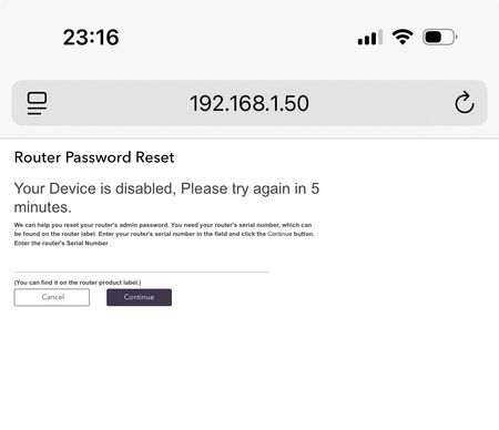

Issues logging into router RS700
I have 2 netgear routers RS700. My main router that is connected to the internet I am able to log into the router to change any settings I may need. The 2nd router that ia connected to the 1st route...
