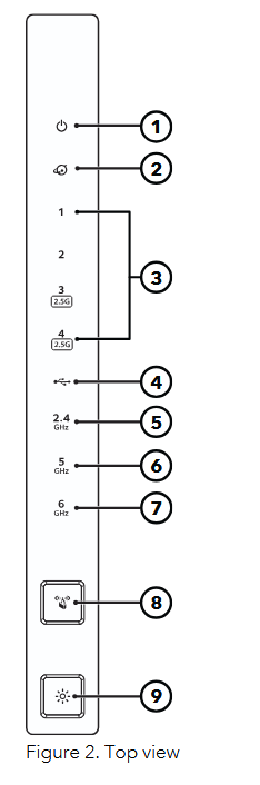

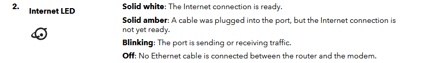

The orange light stays on it
The orange light is?

The ONT works as using before I swapped out the router to the Netgear. But can’t get the Netgear to work. Have reset router and ONT I can use old router to connect through Netgear but that limits my speed as old router is only 1Gb and this is 2.5Gb and my fibre connection is 2.5Gb
The impression I get is that zen internet is based on PPPOE, rather than DHCP, which implies that it requires a User ID and password in the setup.
Does the previous router allow access to the configuration settings to confirm whether it uses ID/password or DHCP?
