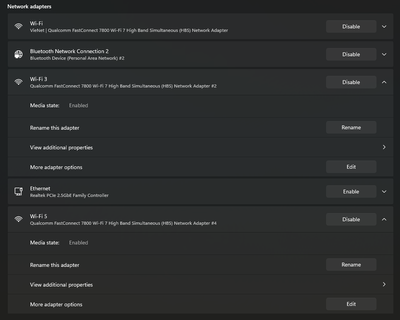

Win11 Network Adapters

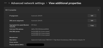

MLO Adapter View

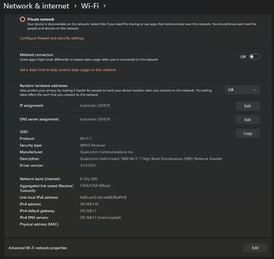

If the RS600 has the feature its not working. Even my Wi-Fi speeds are not breaking the 2Gbps barrier which it should if MLO was in use.
Im still using smart connect so im hoping disabling that I might find a way to enable the feature but before I go poking around and changing things I figured I would post here to see if anyone else has solved this issue. I did see a post on the RS700 but the information in that post was weak. Mostly saying Netgear locked MLO behind a MESH only back-haul. Most people will never need more than 3700 sq/ft coverage so without MLO working on / with clients this becomes a false advertising issue. Same with, 3700 sq. ft. coverage, of which most third-party sites now only show RS600 as 2200 sq/ft. Either way it works for my coverage but it appears that MLO is non-functional.
