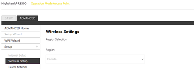

Why does it show "Canada" as the region, not in Canada and greyed out and cannot change.

    1. not sure what you mean by showing canada. You don't have any photos attached to see what you're talking about.

      1. Advanced>Wireless setup> "Region selection" there is a greyed out drop down box which has "Canada" selected. Unable to change.
