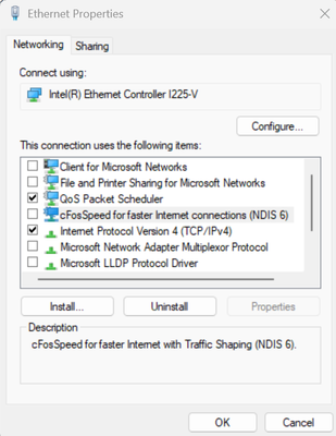

Been scratching my head to figure out this bottleneck.
My WAN shows 2.5 per the router settings being detected. I have my main computer on LAN5 since this is a 10gbps and shows 2.5 in the attached image. I included the speed test from the router directly, which shows 2300mbps down with over 100mbps up, which matches my connection with Cox.
When I run a speed test on my computer connected to LAN5, it stops at 1gbps. The Ethernet controller per the attached image shows it detects 2.5.
Any other thoughts on what I should check or do?
  • Found the root cause.
    Within my Ethernet controller adapter settings, I found "cFosSpeed for faster Internet connections (NDIS 6) and had it disabled. As soon as I disabled it, I could get my full 2.5 GB speed. This was the root cause for my bottleneck keeping the connection at 1GB.

      Also to add the primary computer in question as well as another one tested is an Gigabyte X670E Aorus Master that has the 2.5GB LAN port.
