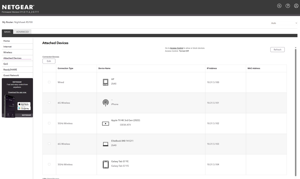

OK, I applied your subnet configuration to my RS700.
Thought default DHCP IP address pool range is set for .100 to .150 for my needs here.
Smart Connect enabled on my router.
Got a few devices connected and there not exhibiting any issues:
- FURRYe38May 27, 2026Guru - Experienced User
Did a couple of reboots on the router.
Router came back to ready in about 2-3 minutes.
I noticed one reboot, two devices had same IP address. I rebooted them.
Rebooted the router a 2nd time. All devices reconnected in good time with out issues.
Will let this run for a day or two.

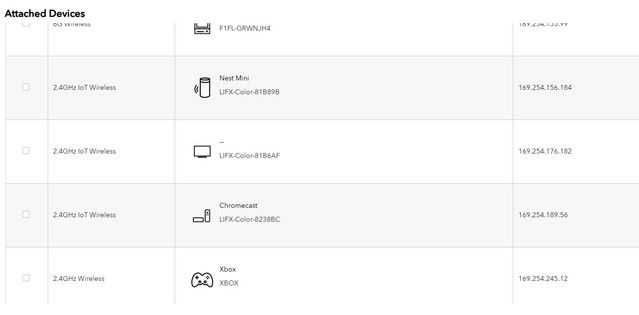

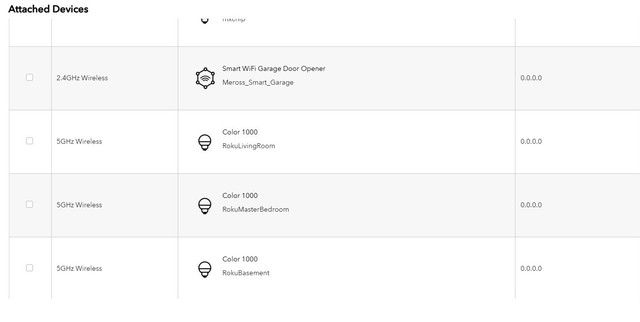

I think I spoke too soon. I did a few reboots last night with smart connect off and it still takes the router around 20-30 mins until it stabilizes and everything connects. With smart connect off I don't have to go into wireless setup and apply the settings each time the router is rebooted though. I just have to wait until things stabilize on their own. I logged in to the web UI last night after a reboot and this is what I saw in connected devices. Still some 169.x.x.x invalid IPs and 0.0.0.0 and I noticed the Device Name and Device Models in the list are switched around between devices. You can see my LIFX bulbs are showing the device name as Rokus and my Nest Mini and Chromecast are showing device name as LIFX bulbs. These are just examples though as there are much more than that. After about 30 minutes everything seems to stabilize and fix itself. This is definitely some weird behavior though.

Wondering if the total amount of connected devices is causing issues.
Any way you can maybe turn OFF some of these devices and see if the router continue to have issues? Possible router is having issues handling this many devices.
