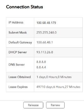

RS700 IPv4 Lease Not Renewing (still not fixed).
I have a Nighthawk RS700 currently running firmware 1.0.9.16. There is a problem with renewing the IPv4 lease. If I restart the router it picks up an Ipv4 address with a 24 hour lease. After 12 ho...

Hi LaddieParker ,
I'm sorry for the late response. As you mentioned, an earlier post reported an issue with the similar symptom, and it's also an ISP in UK. I worked with Intoxicating, who posted that issue, and had the issue fixed. I just PM you the trial firmware v1.0.9.101_25.7.19 which fixes the issue, please give it a try to see if that fixes the issue you ran into.
Thanks.
BH_C

Hi LaddieParker ,
Please try the latest firmware release v1.0.9.16 (https://kb.netgear.com/000070321/), it addresses the DHCP issues introduced by FW v1.0.9.6.
- LaddieParkerNov 03, 2025Guide
I am already running firmware version 1.0.9.16 and I am still experiencing the problem, so it would seem that the fix that it includes doesn't fix all of the DHCP issues.
