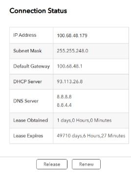

RS700 IPv4 Lease Not Renewing (still not fixed).
I have a Nighthawk RS700 currently running firmware 1.0.9.16. There is a problem with renewing the IPv4 lease. If I restart the router it picks up an Ipv4 address with a 24 hour lease. After 12 ho...

I'd just like to thank all of the people who have tried to help me with this issue over the past few days. I have now worked through all of the suggestions that people made, and I can report that, unfortunately none of them have made a dent in the problem.
The only thing that makes this issue go away is to downgrade to firmware version 1.0.7.96. That being the case I have to assume that the problem was introduced in firmware version 1.0.9.6 and carried over to firmware version 1.0.9.16. I did come up with a workaround for the problem which entailed plugging the router into a timer plug and setting it to turn off the power at 3.00 every morning and then back on a minute later at 3.01, effectively rebooting the router every 24 hours and while this worked, it is far from an ideal solution.

- LaddieParkerNov 10, 2025Guide
Hi BH_C,
I have been running the trial firmware over the weekend and it seems to have fixed the problem.
Many thanks for your help,
