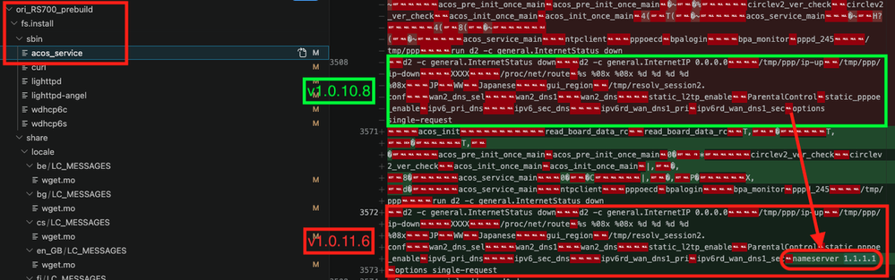

      I have found the possible changes in the GPL source code may help.
      In the screencapture of ori_RS700_prebuild/fs.install/sbin/acos_service,
      we can see there is no "nameserver 1.1.1.1" in v1.0.10.8 (highlighed in green), but it created in v1.0.11.6 (highlighted in red).
      Thank you.
      https://imgur.com/a/kqYJJ9Z

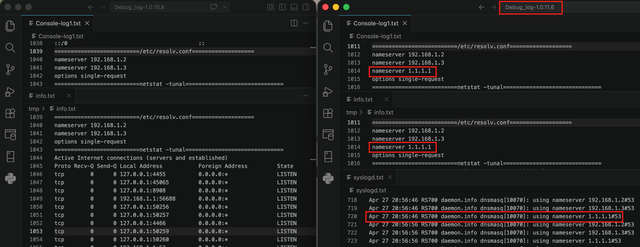

  • Got it! The latest firmware v1.0.11.6 (public release) has added a third DNS entry in the /etc/resolv.conf, which is not present in the previous firmware v1.0.10.8.
    Please check. Thank you.
    (The logs are obtain from the debug page)
    https://imgur.com/a/n26auGB

      Reproduce Procedure - Firmware v1.0.11.6 Public Release:
      Full Factory Reset, then directly go to debug.htm (debug_frame.htm) and dump the debug log.
      You can see the third DNS server ip address entry is auto created by the latest firmware.
      Please fix to avoid any DNS request leak to other unwanted upstream. Thanks.
      ==========================/etc/resolv.conf===================
      nameserver 103.233.166.3
      nameserver 103.233.167.3
      nameserver 1.1.1.1
      options single-request
