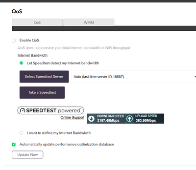

Upload speeds RS700 are slow when compared to etherneted laptop direct to cm3000
Slow upload speeds from rs700+cm3000
  • 2gbit down / 300mb up service plan i am contracted for
  • Comcast tech just left and did a meter-based speed test on the coax line.  the coax line tested at 2300~ down and 480~ upload.  This establishes that the coax is good for the speeds of my contracted plan
  • CM3000 directly connected to a laptop via USB-c to ethernet adaptor gets 980mb (the dongle only supports 1gbit connectivity), and the laptop via the same connection gets 150mb/s~ upload. (its a older laptop... and its a laptop but this establishes a soft control)
  • CM3000 connected to the multi gig port via cat6 to the rs700 test ran both from in the router and the nighthawk app.  Speed test yields solid downloads from 1900 - 2200 mbp/s.  however, the upstream hard walls at 75mbp/s up load this will fluctuate 73,72,75 etc... never past.
rs700 is running firmware :
Firmware Version V1.0.7.86_2.0.82
cm300 is running firmware :
Firmware Version V5.01.02
  • I called into support he had me disable QOS  and first try the thing ripped
