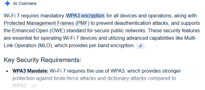

(Caveat: I have no personal experience with WiFi7.) However, it appears that using WiFi7 requires WPA3.
This might put the user in an awkward situation:
- Many devices are not capable of WPA3 and will be left unable to connect if the security level is WPA3 only.
- Perhaps the Samsung phone can distinguish that these security settings are "ok" and the iPhone balks at the combination.
It might be an interesting experiment to temporarily change the WiFi security setting to WPA3 and "see what happens"
- If the iPhone still refuses to connect as WiFi7, well that was a dumb suggestion. sorry.
- If the iPhone will connect with WiFi7, but other devices have problems..... (oh dear).
Might be an interesting 10 minutes.
