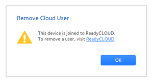

Can't remove cloud user from ReadyNAS RN104
In the past we've had some users access the data on our NAS through ReadyCLOUD. These users no longer access this data and as such we have removed them from ReadyCLOUD. However, they still show u...
Anonymous
Oct 25, 2016Hello DaBro
thanks for reporting issue!IMO you have two options to fix this issue
1.send the log for us to investigate the issue further,we will update you here when we find the cause of issue.
2.unregister/register ReadyCLOUD service to see if it can fix the issue,please note unregistering ReadyCLOUD will remove everything of cloud users,so you will need to backup all the data of /data/home/ReadyCLOUD_FOLDERS first.
