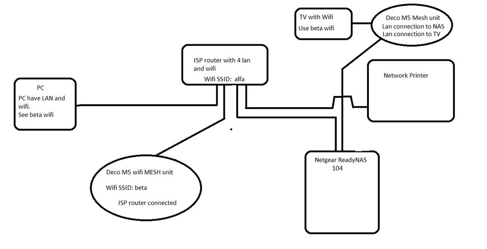

        Tinnsoldaten wrote:
        This is my current setup
        Is routing enabled on the Deco?
        What IP address range are you using for the Deco?  Also what address range are you using for the ISP router?
        What firmware is running on the RN104?
        No matter how the Deco is set up, having bonding enabled on the RN104 is also going to be a problem.
        But I am still thinking that double-routing is getting in the way here, especially if the TV is using DLNA.  That won't go through a NAT firewall (and the Deco is providing that if it is in router mode).
        FWIW, I also double-route, but everthing is connected to my inner router (which is an Orbi mesh).
  • StephenB's avatar
    StephenB
    Tinnsoldaten wrote:
    Port 0 on NAS is connected to ISP router. This allow TV to get acces via LAN to internet, but I dont see NAS.
    Any way I can setup NAS so that I regain full connection with TV-NAS-PC ?
    The Deco M5 is a router, so you are double-routing.  That's why the TV isn't finding the NAS.
    Options are
    • disable routing on the Deco (not sure if this is possible - I'm not seeing it in the manual)
    • connect all your devices to the Deco, and disable the WiFi in the ISP router.
