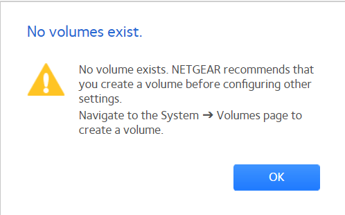

  • Nevermind, "figured it out"... sorta.  All I did was force a reboot, this time unit came up recognizing the volume and all the files. So I guess the lesson is - when you swap disks, and device goes through a complete cycle... then cycle the unit once more for the volume to be properly read. At least on this RN42400 box.

      Thanks StephenB , worked and actually automatically updated to latest 6.10.8 plus latest antivirus.
      However, now it doesn't seem to know the volume(s) I had on the drives. Pictures attached show what I now see. Not sure what to do next?
      • jimk1963's avatar
        jimk1963
        Virtuoso
        RN314 was in XRAID mode, so I believe there was only one volume. I never made multiple volumes.
