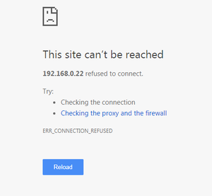

I have one of the above drives which I use to back up my home files.. Ive been looking through this forum and found similar threads all of which Ive tried and I think that Ive come to the conclusion...

Ive checked 1 of my discs with vendor tools (seatool) and it says that everythings fine.
Ive also tried 2 new drives in the bays and that offers me the same results.

Try the new drives one at a time, in bay 1 then bay 2. If you've tried multiple drives, just one at a time, and none are detected or they are detected in only one slot, you almost certainly have a hardware problem. If it affects both slots, it is possible it's the power supply, but unlikely. Unless you are still under warranty, it sounds like time for a new NAS. You can simply put the drives into a new ReadyNAS and the data should be accessible as long as whatever caused the 102 to fail didn't corrupt the volume when it happened. If you were using RAID1, you can put just one drive into the new NAS and verify the data is OK, saving the other in reserve just in case. If you were using RAID0, you'll need to put in both drives.
