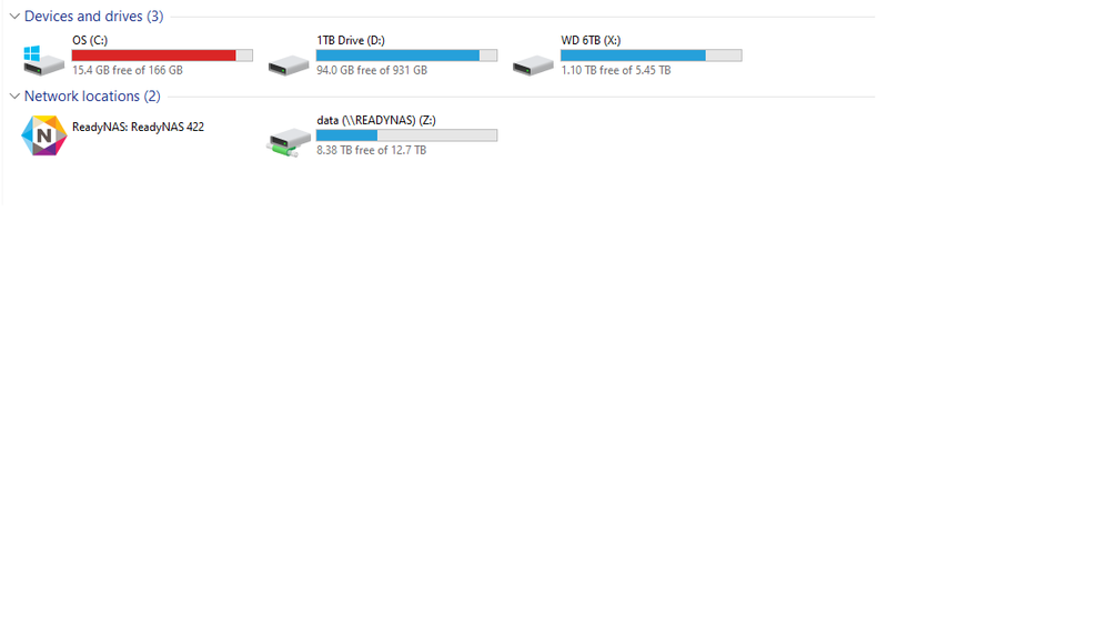

Kenflynn81 wrote:
When I went to transfer to the new HD I did not recreate new share fodlers on the system. I used Windows Map Network Drive to show it was a Z Drive to access the HD from windows and copied/pasted that way.
That is the problem. A share is different from a windows folder you create directly in /data in a number of ways.
Unfortunately the only way to fix it is to delete all the data, create shares, and then copy the data into the shares.
It shows the data on the HD however it shows on the cloud as Snapshot instead of data for some reason.
I'll attach a photo of what I'm meaning
one is showing the Coud data
2nd is windows dat screen showing the data is there.Windows dataCloud photo
