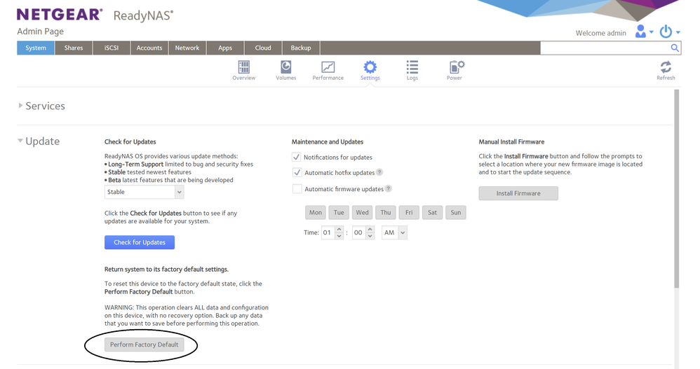

But I think you'd be ok if you just do the factory default from the web admin interface. Do this from System->Settings->Update
This will bring the NAS back to an out-of-the-box state - reformating the disks, and reinstalling the NAS software on them. You'd need to set up the NAS from scratch (recreating shares, etc). All accounts other than admin would be removed, including the ReadyCloud user account. The ReadyCloud service will also be disabled. Don't try to re-enable it - the service is taken down.
Use the normal admin account to set up the NAS (browsing to https://nas-ip-address/admin). The nas-ip-address is a placeholder, you'd need to use your real NAS IP address. You can find that in your router's attached device list. It can also be found on the NAS front panel. (Press the power button once if it is blank). The username is admin. The default password is password which of course should be changed to a strong password during setup.

After setup, you should manually install 6.10.9 software (using the "install firmware" control on the screenshot above). 6.10.9 has some security updates.
