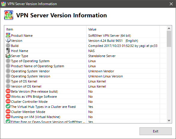

    • Thanks for you post. I was able to successfully upgrade the RN516. I wanted to shared these instructions, because it will simply future upgrades, because in the future you will need to change the file name and remove the apt-get install steps.
      apt-get update
      apt-get upgrade
      apt-get install build-essential
      apt-get install make libc6-dev gcc gdb libtag1-dev uuid-dev
      mkdir /root/softether
      cd /root/softether
      wget http://www.softether-download.com/files/softether/v4.19-9605-beta-2016.03.06-tree/Linux/SoftEther_VPN_Server/64bit_-_Intel_x64_or_AMD64/softether-vpnserver-v4.19-9605-beta-2016.03.06-linux-x64-64bit.tar.gz
      tar xvf softether-vpnserver-v4.19-9605-beta-2016.03.06-linux-x64-64bit.tar.gz
      cp -avr /apps/vpnserver/bin/vpn_server.config /root/softether/vpnserver/
      cp -avr /apps/vpnserver/bin/vpn_server.config.save /root/softether/vpnserver/
      make
      1
      1
      1
      cp -avr /root/softether/vpnserver/* /apps/vpnserver/bin/arm
      cp -avr /apps/vpnserver/bin/arm/* /apps/vpnserver/bin
      cd /apps/vpnserver/bin/arm
      ./vpncmd
      3
      check
      exit
      cd /apps/vpnserver
      chown -R admin:admin bin/
      rm -rf /root/softether

  • Thank you, this worked for me (ReadyNAS 314)
    did have to add the below before the make command, but this made it very easy to upgrade, thanks
    cd /root/softether/vpnserver
