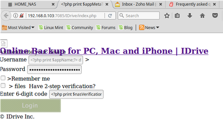

 Hi,  Has anyone else had problems with the IDrive app (V1.00.09) working with the latest firmware for the ReadyNAS 204?  I can install the IDrive app without any problems but when I try to launch it ...

Also tried 6.7.5 beta no change. But I also notice that I currently cannot enable Readycloud. Started about two weeks ago. No idea why and no remedies raised in prior threads work. I raised another thread for this here https://community.netgear.com/t5/ReadyCLOUD/ReadyCLOUD-not-connecting/m-p/1300818#M8500. No idea if the two are related.

Just got my connectivity back. Is there any update on this? I still cannot get iDrive to work.

Hi LeapingLemming,
Did you try my fix posted above? Basically, you connect to the ReadyNAS as root with SSH and copy the 2 files php5.conf and php5.load in /etc/apache2/mods-available to /etc/apache2/mods-enabled
Then reboot the ReadyNAS and it should work.

 - LeapingLemmingJun 24, 2017TutorYes I did thanks. In 6.7.5 the php files are in the enabled directory. The final trick is to change browsers as I discovered after many hours. So working now.
