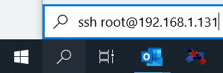

Tried the ssh root@/192.168.1.131 in browser URL - this is clearly wrong.
No slash. And you don't do this in the browser. You enter this command via the windows search icon in the windows 10 task bar.
CABird_UK wrote:
Use root for the user name, and the NAS admin password. I'm confused.
You are overthinking it. Just follow the instructions - use the NAS admin password with you log in with ssh. Root is already taken care of, since you used it in the ssh command (root@)
