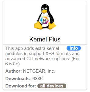

Some addons do need the Kernel Plus addon as well. In another thread, a user reported that was the solution to his Docker issue, though I believe he also had to do some re-configuring, but I don't know whether that was because of other things he tried first or is always necessary..

What exactly is the Kernal Plus package that has been mentioned?

I have that added to my readynas - doesn't resolve docker daemon startup issue.
- SandsharkMay 30, 2021Sensei
My understanding of the Kernel Plus app is that it installs linux-image-extra (possibly among other things). Since linux-image-extra is specific to an OS version, I would think you'd need to do something to get it to update. But I don't know if Netgear has actually updated it or how one goes about updating it since it doesn't list a version number that corresponds to an OS build..
