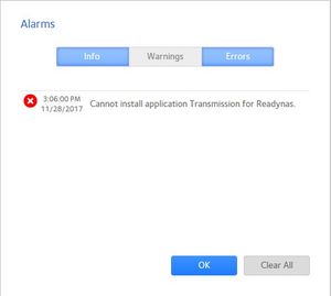

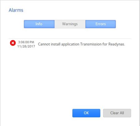

RN102 Firmware update (6.9.1) - Apps won't install
Sorry, copy-paste :) I hope someonce can help when I try to install any app from available apps serction on the admin page it fails and says apps operation failed Application list might be missin...

It looks like you might have installed rsyslog (and that is causing the issues). Can you try uninstalling that?
- amethystiumDec 03, 2017Aspirant
Try remove rsyslog via SSH
