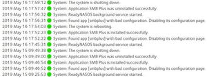

May 18, 2019SMB plus not running on RN104 under OS 6.10.0 Hotfix2
While not having any issues with my RN426 (OS6.9.5 HF1 Long-term Support) and RN204 (OS6.10.0 HF2), good ol' RN104 (OS6.10.0 HF2) is refusing to run SMB plus, though it claims that the app was succes...

Just for the records: Upgrading to 6.10.1 a few minutes ago is not fixing this. Installation and De-installation is successful, but the configuration page cannot be invoked as the system has disabled it (see screenshot in first message of this thread).
