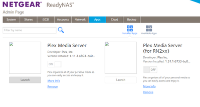

Hello,
I tried to upgrade my Plex Media Server SW and ended up with 2 versions on my ReadyNAS. I am unable to uninstall either of them.  I have a ReadyNAS 102 with OS 6.10.8.  I am using MS Edge on my PC. I am unable to delete either of these apps installed on my ReadyNAS. I have rebooted the ReadyNAS. But no luck.

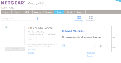

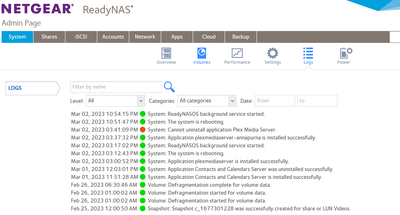

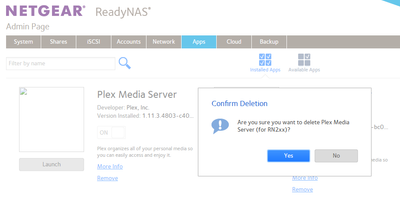

The first picture shows the 2 Plex apps installed on ReadyNAS and the 2nd and 3rd picture shows how it is trying to uninstall the app. It stays on this screen with the dial turning for a while, but ultimately does not get uninstalled. The 4th picture is of the logs. Any help is much appreciated!

    Not sure how to fix it, but it appears that you tried to install the version for the RN200 series over the RN100 series version you had before.
    They would have been installed to the same folder on the NAS, so you probably need to remove both of them.  That could require manually deleting the plex folders in /data/.apps.
