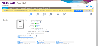

We have a variety of external disks (150+ over many sites) that we attach to the NAS for external backup that are taken to off-site storage. It is part of the normal operational routine. Been worki...

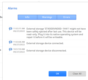

Typically the read-only status occurs because the "dirty" bit on the USB disk is set when the disk is mounted (which normally is cleared when the disk is properly dismounted). Windows will see this and offer to repair.

Here is the ReadyNAS admonishment about read only.

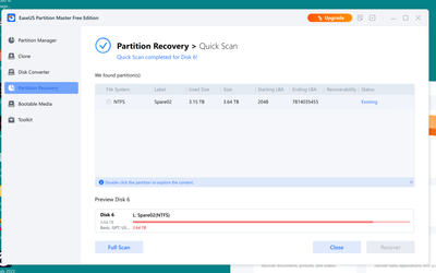

Took the drive to a Windows 11 system and ran EaseUS after a clean workstation boot. Drive was seen.
No Windows admonishment regarding repair or the equivalent.
Can open the drive in File Explorer.
Can copy data to the drive using File Explorer. Disk Manager sees the drive as well.
Seems like it is OK in the Windows system. It is obvious that the file system is not corrupted or damaged.
Took the drive back to the ReadyNAS and received the same error message.
Something hinky here – works in Windows but ReadyNAS blocks it. Could this be a result of the recent OS upgrade just released?
