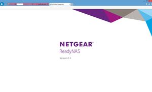

Administrative page won't show up - ReadyNAS 314
Hi everyone, We work at a research station in a remote area where we don't have a lot of internet, so the PC we use to connect to the ReadyNAS 314 does not have an internet connection. We have a...

After connecting the NAS and PC directly, I have changed the IP of the PC to 169.254.198.100, gateway to 169.254.198.1 and subnet mask to 255.255.255.0 but as I try to connect to https://169.254.198.100/admin an error message tells me I can't reach this page. Am I doing something wrong? Should I change the IP of the Wi-Fi, or as I was doing, the Ethernet one?
Turn off the wifi for now, it just gets in the way.
You should have typed https://169.254.198.169/admin - because you are trying the reach the NAS, not the PC.

-> The IP address of the RN 314 is: 169.254.201.55.
I have reconnected the Wi-Fi card and can now access the admin page when the Wi-Fi is off and I have checked: I can save some data to the RN 314.
Still, I wonder why I can access the admin page only when the Wi-Fi is off? Should I consider changing the IP address of the RN 314 to something like 192.168.1.xxx?

-> The IP address of the RN 314 is now (after being upgraded): 169.254.71.1
This really should also be assigned a 192.168.1.x address.
Here's an explanation: The subnet mask (255.255.255.0) is used by all your devices to determine whether the device they are trying to reach is local (on the same subnet) or remote (not on the subnet). A better name for "remote" is "off-net".
The IP addresses and masks are all 4 bytes - 255 therefore is all ones.
So when the PC tries to reach 169.254.71.1,
it "ands" that value with the subnet mask -> resulting in 169.254.71.0.
It then similarly "ands" its own address with the subnet mask -> resulting in 192.168.1.0
If then compares the two results. If they match, the destination is on the subnet, so the PC then finds the ethernet MAC address for the NAS using a protocol called ARP. IT then constructs packets with the destination MAC ethernet address and the destination IP address. Your switches then know how to route the data to the NAS (layer-1 switches just use MAC addresses and totally ignore the IP addresses).
In your case they don't match, so the NAS is off-net. In an IP network, all off-net traffic is sent to the gateway - and you don't have a gateway configured. You are a bit lucky that you can reach the NAS at all this way.
Figuring out exactly what happens when WiFi is on requires a bit more information (asked for above). But I suspect the PC is trying to directing the NAS data to the WiFi link, which is then unable to deliver it to the NAS.

"This really should also be assigned a 192.168.1.x address." I have assigned the IP of the ReadyNAS 314 to 192.168.1.150 and it is working (I can access the admin page).
